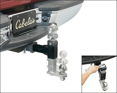

Get an adjustable one. I saw this one at wal-mart for 45.00
Attachment 30726
Adjustable one looks loke the way to go
