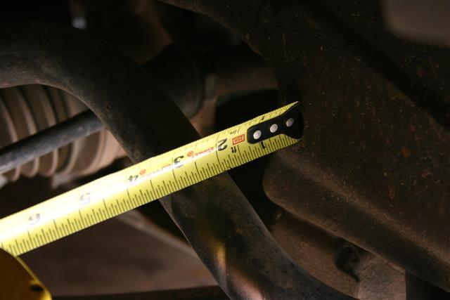

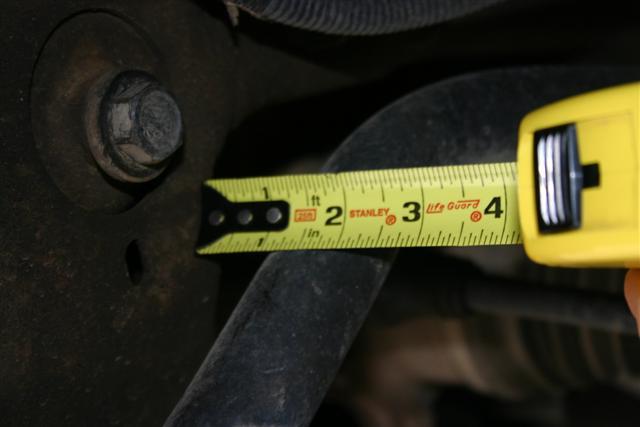

I was just wondering if anyone in the world sells aftermarket swaybar bushings. I got in my rig this morning, and the tire rubbed on the swaybar really bad. When I measured from side to side, it is about 1 inch out of center. (it moved to passenger)

It's the front bushings mounted up against the frame. (in the middle of the swaybar) I was looking around town today, and on the internet and Energy Suspension doesn't have any for an H2. ??? I figured they were the same as any other part for a Chev/GM truck.
My swaybar links, behind the tie rods, were replaced a month ago. Those bushings no longer existed. This trouble is brand new, like I drove it on Sunday, and noticed it backing out of the driveway the next morning. I did pull a heavier load than normal over a cra p p y road though.
My dealership said they could have stock ones sent in for 19.00/each.
I kinda wanted the ones you can grease. The dealership had another name for the part. I think it was anit sway sleeve, or something. sorry can't remember.
I had hoped that I could get the grease-able synthetic kind from Energy Suspension and be done with it ...

OK, I'm gonna take the simpleton approach here. Why does it matter of the sway bar is cocked over to one side by and inch? What performance problems does this cause? My front sway bar is 1-1.5 inches to the passenger side, has been for years. It's even polished from the rub of my old stock tires. It's never bothered me and I haven't noticed any poor performance.
My theory is that I'll just go until the bushings fall off and the bar disconnects. I can still wheel it home, then replace them. What am I missing here?

Well for one thing, if it's centered your wheels won't rub if you run the BFG muds, and will only rub slightly with the AT's, and if the bushings are good they won't squeak all the time.
Your theory of drive it till it drops is sound. Reminds me of another Colorado Hummer driver I know
I was wondering if anyone has replaced theirs lately and what kind did they put on? I can't seem to find the Energy Suspension ones Phil is talking about. It's like they discontinued them.
