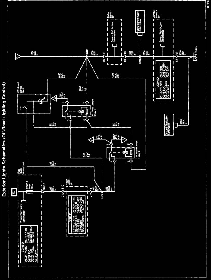

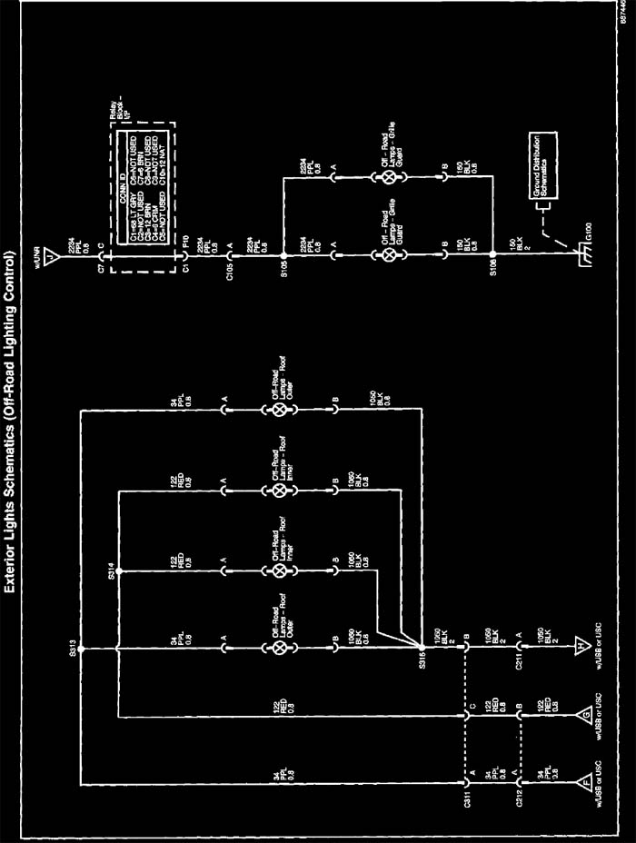

I need to see where and what color the wires are coming from the fog light switch in the overhead consol.

Hey man, sorry about the delayed answer. Got home this afternoon and found my server had crashed so just spent the whole evening reinstalling and configuring. Just now got back online. Haven't had the chance to get the service data installed again yet, but will tomorrow.
You've got a PM btw

Do these help any?
