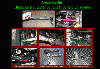

http://www.fly-n-hi.com/gm_steering.html
Heavy duty ties rod stuff. If this stuff breaks. I’m I out of luck trying to replace with stock tie rod parts. Or should I stay all stock OEM carry stock replacement parts.

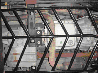

Will this help? Pictures below.
Front skid cage

There has been much debate about the H2 Tie Rods.
Personally I think they are too small. However, all of the replacements I've seen, I feel are too strong, and could cause transfered energy to break a much more expensive part that would be harder to fix.
For now I think the best bet is to carry a spare.

If anyone wants some SS sleeves to reinforce the tierods I can PM u the info for person that makes these for the HD p/u trucks.
They are bending or breaking the tierods dragracing.
Yell'r 04 Lux w/ air, sunroof,F&R brush bars
04 Chevy D/A CC SLT LB
98 ZR-2 Blazer
Ex H2&3 owner
Old 03-08-2004, 04:51 PM
Location: N.CENTRAL OHIO
Posts: 474
DURAMAX TIM is off the scale
The pic I tried to borrow and paste was too big so I'll have to resize later and post it.
The guy is selling them for $75 shipped.
The OD is 1" and it buts up to the lock nut and extends to the inner boot.
