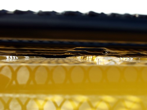

I've had the Gobi rack on my roof for almost 4 years and haven't once heard it bang against the roof. Many time's I've been offroad with the tire on too (Stock BFG). While there isn't a lot of clearance, they designed it to stay rigid enought to not touch.
I'm not saying you don't have this problem, but if so I'd contact Gobi. Paul or Sandra will take care of you.
Here's an old picture of my clearance.

Ahhh. Yep, that's likely your problem. I suppose they don't need to put the indents in there when it's supposed to be 4+ inches away. that would be overkill. But when the clearance it tight, you need it like in my pic of my stealth rack. I suppose you could have those tubes notched inward. Call Gobi and get their suggestion how to do it while maintaining the strength on those cross members. It's doesn't appear to that it would overly difficult.
