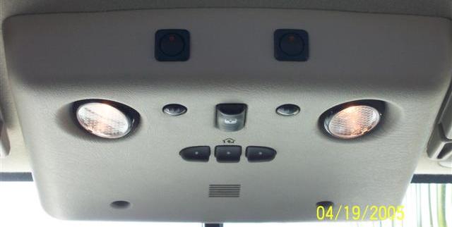

Thanks for the replies. I am leaning to the 580's. As for the switches, I remeber seeing someones h2 with them up in the overhead console. It looked looked almost stock. They were round rockers w/ a light to indicate "on". Are those the PIAA ones?

I mounted the Radio Shack switches like the ones in the photo above, and left enough room in between for a tilt-o-meter.

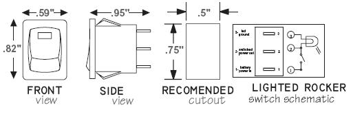

I haven't yet replaced the stock PIAA switches. I found some DC rated mini rockers small enough so I think I can put two of them side-by-side into the "blank" below the rear washer switch instead of using the larger, round radio shack style rockers that most people have used (picts on next posts).
Stylewise, they're a departure from the dash style, but I think they'll fit okay. I found them here for about $4.50 a piece (follow the second link in the body for "mini rocker switches.") I take the plunge tomorrow to hack up my switch assemby and find out if this'll work for sure.

American Technology's mini rocker dimensions and schematics.

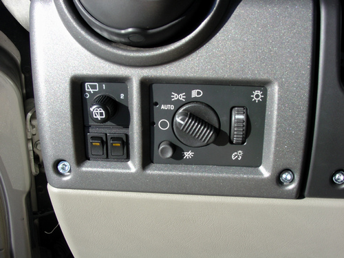

For those curious about switch alternatives, I finally mounted the mini rockers I described above under the rear wiper switch.
Because they are rectangular, I drew cutouts on the black plastic using pencil, roughed out the holes with a dremel, and then very slowly and carefully used an xacto knife to carve out to the edges of my cutout drawings. I had to hack a lot of the wiper switch frame out in order to fit these because they're deep and they're two of them, but I got it to fit.
Below's the finished product. It certainly doesn't match the H2's dash styling, but they're compact and in a convenient single location rather than having two of the larger switches overhead or slopped on the dash or worse, spread between that blank and the one under the tow button in the center console.

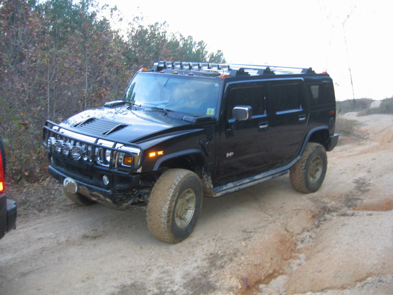

I went with 4 Warn SDB-160 Dual Beam Spot Lights on the front using the Warn light bar. I pretty much copied James on the Switch install, but can't find a pic. I am very impressed with the Warn lights, but like others here can't comment on other brands becasue I haven't used them. Here is a recent day shot.
