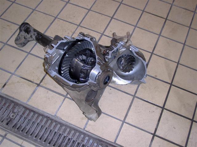

Lot's of torque + sticky tires + steep slickrock + slight bounce = blown T-Case.
I know.

Thats A good situation to use the brake/throttle together, when the tire bounces the brakes will stop or slow wheel spin so that nothing gets shock loaded when the tire lands. Also you can build A toe clip for your throttle pedal for better foot control in bouncy situations.

I know also.
I was Brake Throttle Modulating (BTM). The rear just barely bounced, not OFF the ground, the tires were still in contact with the ground, small slip and BANG!

Well, nothing really lives until it has bled a little.... I guess I need to get the truck dirty and hope nothing explodes like Working Hummer's.... I had a front diff blow up on me with a CJ-7 but that was from lack of torque. LOL

Speaking from experience the supercharger will help keep those tires spinning even when the traction control is slowing the vehicle down.
It is when you get in those situations where you have all your weight on one wheel going straight up a rock (with the rear locked) that you begin to break things. Technique? yeah probably! Will use less throttle when trying to climb from now own. Being from a mud area, I am use to pressing the throttle when your momentum slows. Not a good idea on rock with great traction (1 transmission, 2 rear axles). All on rock.
