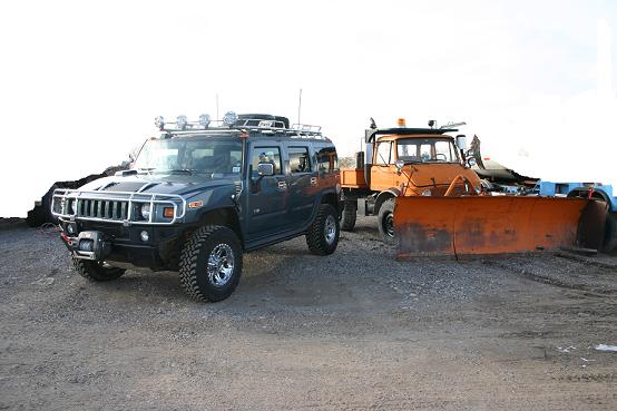

There is no doubt that they are BIG

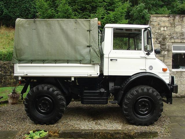

Screw just the tires, I want the entire UNIMOG. Those things are excellent!
50-60 on the highway isnt dangerous.....Ill only go 55 max speed in my h2 (18-19 MPG =))).
