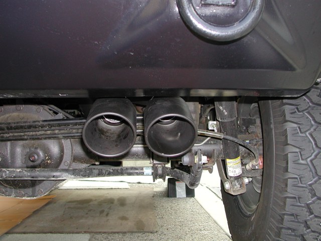

I have the Borla Dual Exhaust on a 2003 H2. It's a bit louder than I wanted but am happy.

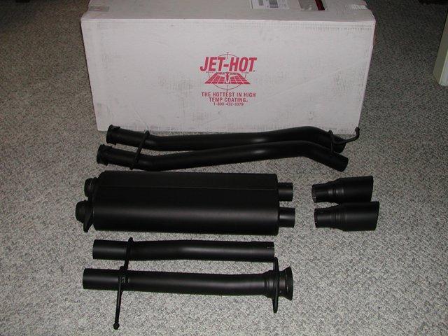

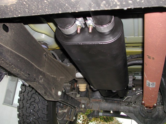

I had the whole thing ceramic coated black at Jet Hot. I am posting before and after shots. I apologize for the picture of the rear of the vehicle, might not be the best angle that you were looking for. I did cut about 2 inches off of the end of the pipes before installing the tips, because they stuck out a bit more than I liked. The pictures of the unistalled pipes, is before I trimmed the end off.

After Installing Borla

Borla 2

Borla 3

Is it too much asked if you pointed out in that second picture of yours where exactly did you cut 2 inches off?

In the second picture, the top pipe (pipes) just in front of the box, the right end of it is actually the tail end that goes out the back of the vehicle. Just to the right of the hanger, on the end, I measured into the 2 end tips to see how much pipe they would need to clamp on to, and figured out how much extra pipe I could do without and broke out the sawzall. The 2 clamp on tips now butt up to the end hanger. I did this just to pull the tips as far back under the vehicle as possible.
Hope this helps.

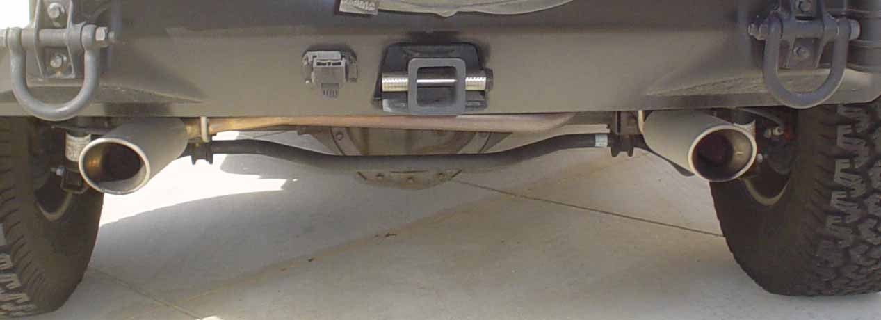

Here's a pic of my borla dual exhaust.
