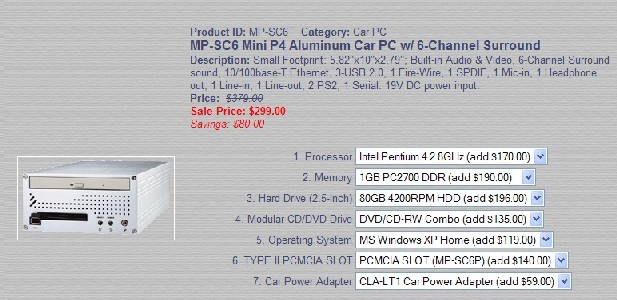

Thanks for the links. I found this on the xenarcdirect site

Those were the ones I was looking at -- which would have the power probs. Have not considered a notebook, since I figured the extra expense of an unused screen can go towards better CPU/HD/RAM (not everyone have an extra notebook lying around )

40 GHz hard drive, huh? (In response to the advertisement for the MIS.)
