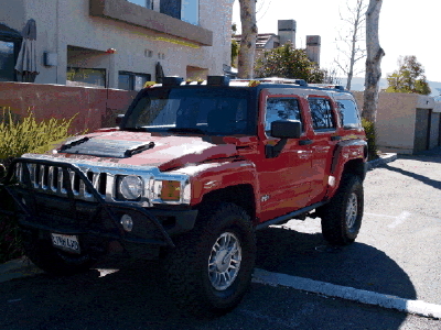

I'm runnning 35's (315/75/R16) on stock rims and having no problems. If I do a full hard right turn it Just slightly rubs but Just so I don't think you can go any larger.
Old 02-28-2008, 09:57 PM
bonzaiii bonzaiii is offline
Join Date: Nov 2006
Posts: 35
bonzaiii is on a distinguished road
Default Re: Largest Tires that will fit a Base H3
Here is a pic of the 35's
