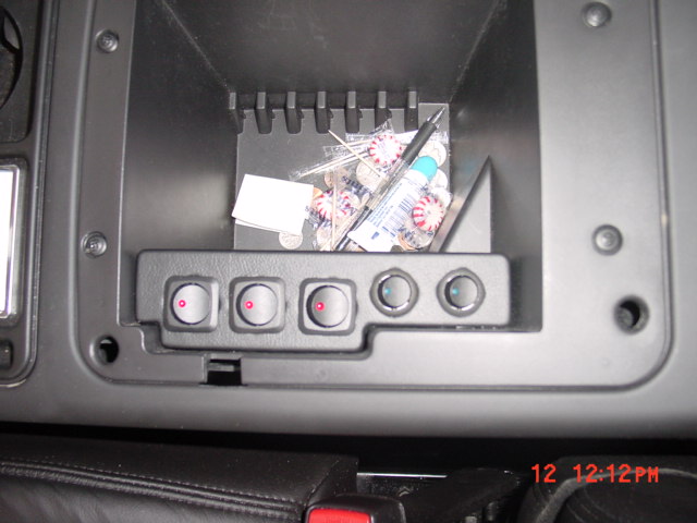

I had this custom black vinyl-wrapped switch panel made that fits inside my console.
The two areas/holes drilled for these two switches reached their max size and does not allow for a larger diameter switch to be used there (as in the ones at Radio Shack).
If you look inside your console to the left, you will see a little ledge there. We put this panel right there above that ledge. It looks really good.
There are a total of 5 swithes there. Two towards the back are the smaller Delta switches. You can see how this worked out well because there is less room in this are for larger diameter switches.
The three towards the front are for inside cab winch solenoid (can't open hood with Winch mounted in front to access under hood switch. A relay was also added for so both switches work in conjunction), manual control of DRL lights, and a spare for future.
The entire layout looks like:
1. Spare
2. Winch
3. DRLs
4. Outside Delta Lights
5. Inside Delta Lights
...and CDs can still fit in the console

tomp---I got the same switches you see in the pic. They look good and work fine.
