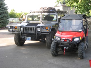

I have that setup, but the Ranger isn't pictured here. I like the wagon because it's got so much interior room (dry storage) and I put a rack on top for gas, water, and tools. I also have the ax, shovel and hi lift mounted on the rack to keep it out of the interior. The Alpha has plenty of power.  I tow a small trailer regularly, and I have towed our toy hauler with it once. It has plenty of power, but it's not going to pull the same as a pickup.
