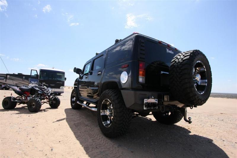

I have 37.5x 13.5 on 20's, they tweaked the front torsion bars a bit to make it fit and I love the way it looks now. The car's look is night and day difference. I didnt regear, there wasnt a need for it since I always drove slow and didnt tow much. Now that I am looking into towing a 7,000 lb trailer I might get it done, still not sure. Any ideas on the cost? The speedo is off a bit, but power is fine. Breaking is a bit softer, but again it has been worth it. I get tons of compliments on the car. MPG did decrease to 9.5 in city driving, but again completely worth it.

Wow Kalantar
That setup looks great.
Do you have anymore pictures. (didn't do a search from them)
What brand are those tires and rims.
Looking exelent
Regards
Rene

http://www.elcovaforums.com/forums/s...ad.php?t=33433
I dont have the rear air suspension, so that is why 13.5 fit on my h2.
Truck looks great. So since I have the air suspension I couldn't run this setup?
