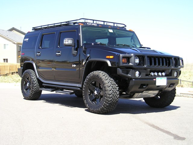

I know everyone has these wheels but I can't find anything that I like better. I live in Ga so not many people have them. We all have the MotoMetal 951's. Every other truck on the road has them. I am looking at getting 18x9's. Running a 35x12.5 nitto mud grappler what backspacing will work. There is a smoking deal on ebay right now. They have 5" of backspacing. Will that work? I know a few of you guys are running these maybe someone can chime in. I'm dying to get the stockers off the truck

The rockstar is a 0 offset with 5" bs on them for our lug pattern. So you're good to go with those specs.
I ran them with 35 12.50 18 toyo mt. Here's how they fit...

Thanks Tim! Is that stock suspension in the picture? No leveling kit? I don't really wont to crank of the torsion bars so I am trying to get an idea of what it will look like stock. Thanks man!

stock height. with the more aggressive tires I did put the rancho steering stabilizer on though, but as far as stock height, there were no raising the tbars or anything like that.
One more thing to consider if you haven;t had the grapplers yet, they look cool, but ride pretty rough and wear down quickly from what I've seen/read.
If you're looking at the guy on Ebay (RIMZONE)that puts the packages together, you may want to ask him what other deals on tires are available. I'm assuming this is your daily driver.
