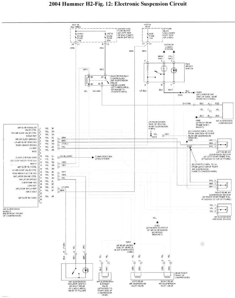

I have an infamous air suspension problem. I got a wiring diagram so perhaps this will be useful to others as well.
We are working with a 04 Hummer H2 with elec. air suspension. The suspension did not react at all. I found that the ground from the suspension ecu was broken, and now I am able to use the inflator only but it?s really weak...
The compressor won?t turn on and all the sensors seem to be in tact.
I wonder how I can test the pressure sensor and if there are any other things to diagnose.
The main relay works and proof is that the inflator initiates the compressor. I haven?t done a bag leak test as I haven?t been able to fill them yet. I will do this tonight by rigging the bags with direct air from my house compressor. (found this from a user who posted it on this forum. - Thanks for that hint!)
Thanks in advance for your help. Haven?t taken it to a dealership, hope to get a look over it myself before paying through the nose. It seems that issues like this can end up costs a ton of dough if the service guy isn?t up to snuff on the air ride suspension.
Cheers,
Tony

I was able to get rid of this message by finding a disconnected ecu ground on the compressor frame. This ground is located right in front of the compressor and is bolted on the frame... Could it be a rely that would be sluggish? Just speculating.
On the weekend, i removed the entire compressor apparatus and connected the air bags to a Tee. Now the car is elevated correctly at around 65psi. There doesnt seem to be a leak. i sprayed soapy water and no bubbles.
I determined that there is power going to the unit so the relay up front is good. The inflator in the trunk works okay although seems weak.
Does anyone have any suggesstions on how i can test the valves and pressure sensor with the unit off the truck?
When all together, no messages come up, the compressor will not turn on to fill the bags. The inflator works. The front elevation button light does not turn on nor does anything happen.
Another issue i have is 4x4 switching does not seem to work. The button will blink but it will never switch.
All fuses seem to be okay.
Sorry for the long post but hopefully that gives you enough clues and we can figure something out.
