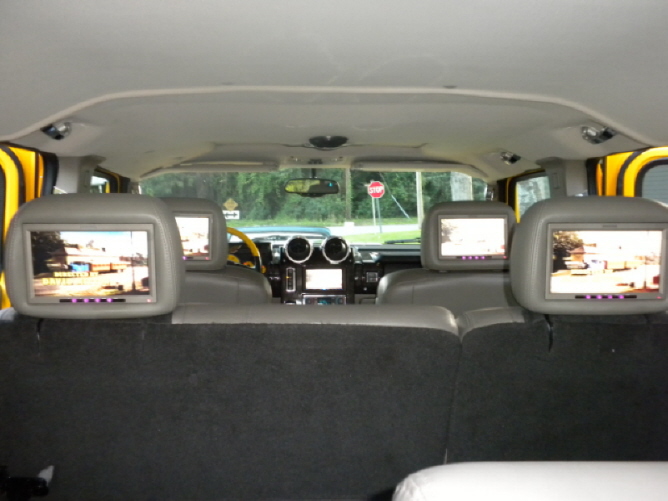

Im looking to get the A1000 or the A2000 for my 05 Hummer H2. Now here is my question. I have a avic 90BT touch screen headunit installed that has navigation and dvd capilities. Is there a way to have the 2 headrest units play what is playing on the headunit?? Thanks guys in advance

YES
It can be done I have 4 visualogic 9 inch headrest monitors in mine with amplifiers and they work great. They also have dual input and can work with wireless headsets (works great for kids). I will see and snap a pic for you. Never the less you will need amps for the monitors. Mine came with them.

PIC

Amazing Hummer H2R. Im still waiting for my bulletprof stuff to come thru. Hey so even tought eh A-2000 has its own DVD player. I should have no problem connecting them all to the headunit with a video amplifier. It is not the same thing as te fm mod is it?

Each of the monitors comes with a dual input Amplifier when they were bought from Visualogic, I am not sure how they are supplied these days as I purchased mine 2 years ago. I mounted one dvd player under the rear seat and the other input is from the head unit. I put the kids on one program with wireless head phones, and enjoy what I want from the head unit. This has worked well for my situation, including the interfaces for the bose speakers and the steering wheel controls. overall I am pleased with the outcome.
