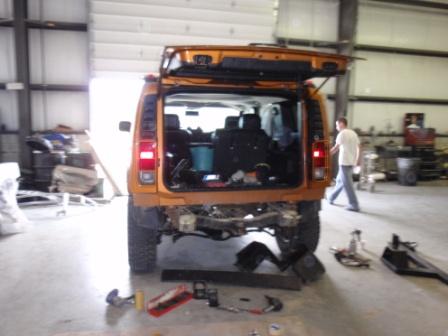

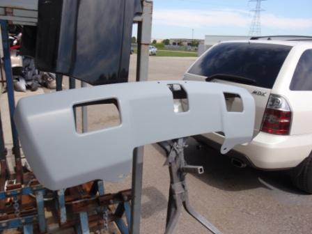

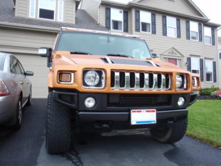

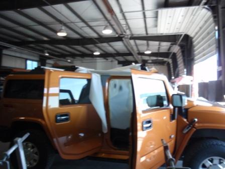

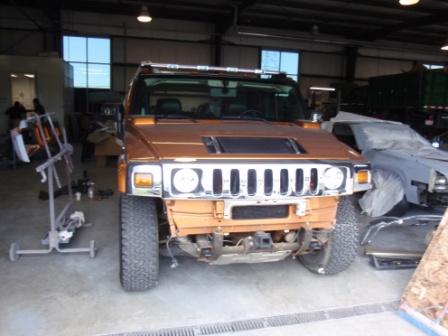

The front bumper had a lot of rock chips and the rear bumper was starting to rust around the tow hook bracket mounting area. Stripped both bumpers and repainted. Used base/clearcoat on bumpers with an eggshell flattening agent added to the clear to make the bumper look exactly as they did from the factory. The brush bar mount bracket had taken a rock chip and started to rust so fixed that as well as some gouges in the bar. The right side B Pillar had some gouges from someone using a coat hanger to unlock the door and took care of thise as well.. Pics attached below.

They look great!
My bumpers get scratched up quiet a bit as I do quiet a bit of offroading. So I just use bedliner in a can. It has worked out really well for me!
