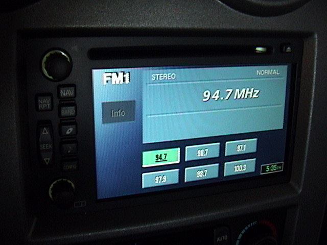

finally got out and took some pics of my install

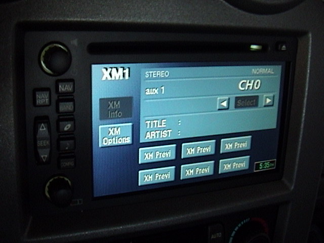

2

Looks very nice -- exactly like my '05! Go figure!
Did you put in a CD changer, too?

the sound from the dvd come through the aux1 on the xm band

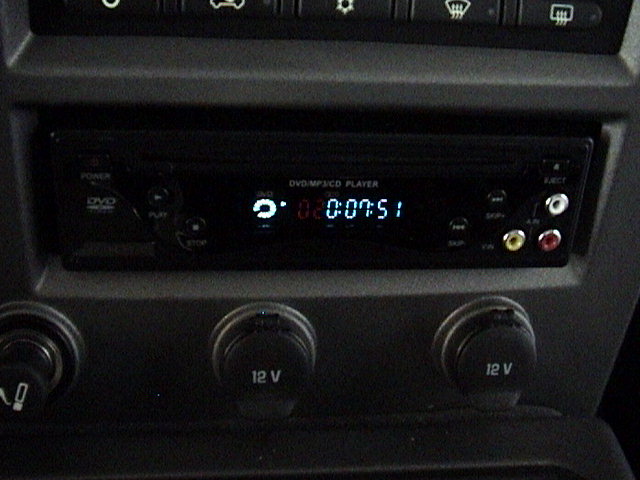

in dash dvd player

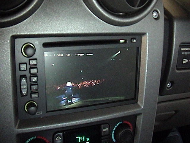

i placed 3 switches here as you can see the one labeled nav allows my passenger (LOL)to use all the nav options while the vehicle is in motion. The one labled dvd will turn the dvd onto the screen. and of course the cam will allow me to activate a rear camera while driving.

allthough these pics aren't the best quality the sharpness on the screen from the dvd is excellent.

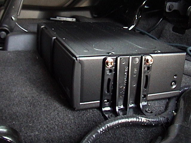

6 disc changer under the rear seats

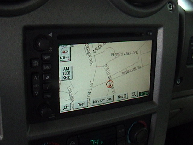

and of course the nav

its a visualogic http://www.jpcustoms.com/store/customer/product.php?pro...16390&cat=332&page=1
i removed the onstar and placed the dvd player there. i did have to modify the back of the dash behind the onstar. There is a bracket that i had to cut back so the dvd player would fit nice you will also notice that it is a little bigger than a standard din opening. so i used window sealing foam tape 1/2 and just ran it around the unit. i suppose you could find a face plate but it looks good for me so i will keep it that way. when i modified the bracket in the back i took a little out at a time and checked fitment (depth) each time till i was satisfied with the look
