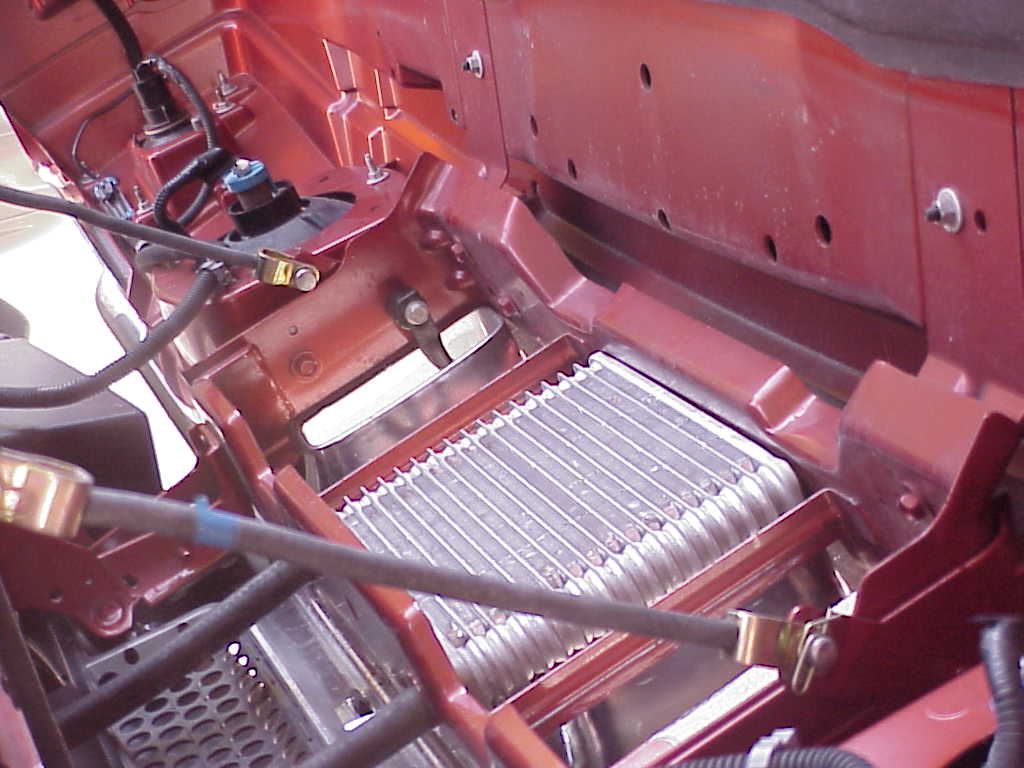

Here's the proof.
03/sunset orange supercharged & custom programed-- gale banks monster exhaust

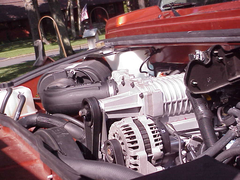

One more

Last One
