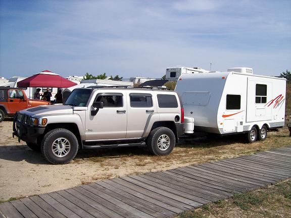

Old 11-30-2009, 04:10 AM
fourfourto's Avatar
Default Re: 15,000 mile oil change...
I use a friction swaybar on the right side and it works well.
No sway up to 80MPH I try not to go over 75.
JC whitney
JC whitney
Ya, I saw your post about a year ago when you got your trailer. That where I got the idea. Thanks.
Just waiting till closer to spring to get it.
