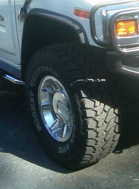

I have had these Mickey Thompson's for about six months and have been very happy with them. They are 35 12.50 x 17 and slightly larger than stock. I believe they have them in 18" also. I got them through 4wheel parts and was very happy with both service and price. (5) $1435.XX
