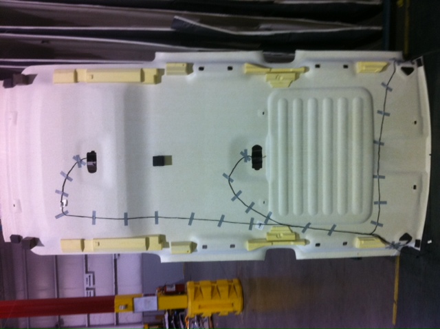

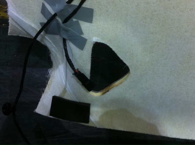

Here is a basic headliner and how the wiring looks underneath. The wire connector should be right there. Here is the pictures.

Thank you...Thank you...Thank you... That's exactly what I needed. If there's anything I can ever assist you with in the Sarasota, Florida area, please don't hesitate to give me a shout. Once again, thank you so much! I just purchased a new sun visor for $147.00 and the dealer wanted $120.00 to install it. To remove three screws, unplug and plug in the new one = $120.00 at the dealer...that's just not right. Hope you have an awesome weekend... "Rico"
