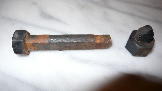

Hey guys, today while replacing one of my hubs, I decided to torque some bolts to see if I could get rid of some clunking in the front. So I went out and picked up the washers for the front cross member and decided to get some work done. Well I torqued the front 4 body mounts to 63 fp, then I moved to the upper control arm and my paper said it was 261 fp... Well I don?t think that was true, or my torque wrench is jacked up... I snapped one of the camber bolts... now I am stuck in the middle of my driveway with the front driver side up in the air.
Anyone know where I can get the bolt? Am I stuck going to the dealer on Monday? Guessing a Chevy 2500HD would be the same?

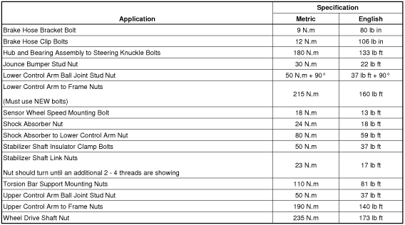

Hi this is for a 2008 but its likey the same torque specs for your truck, upper control arm bolts are torqued to 140 ft.pounds. Sorry i don't have a bolt.

thanks, I was only off by 120 FP...

No dealer had the bolts... I found one in a parts yard, back on good as new.
