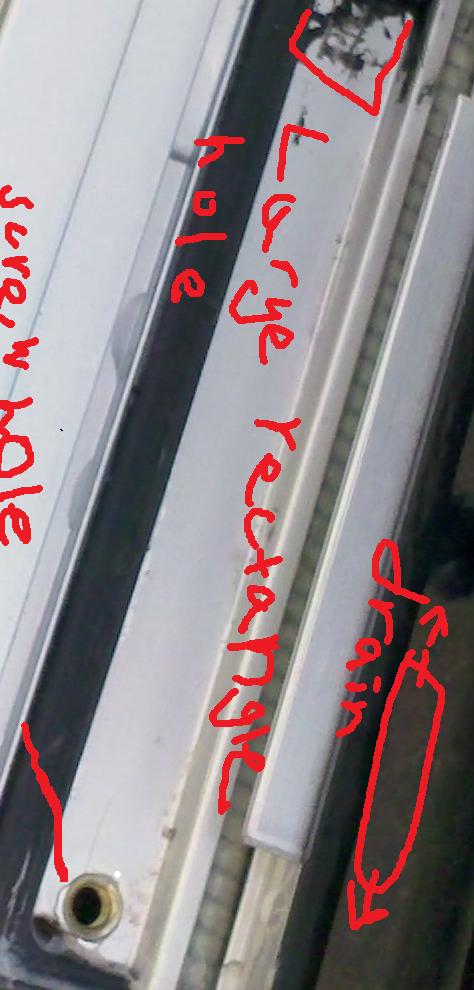

4. I've had a leak coming from the roof i've removed the headliner and I've found that the leak is coming from the sun roof frame. Beside the Side roof drain their is a square hole and back of that is a screw hole, they both easily can be leaked on from the drain, the simply drain onto the headlinerwhich then goes down the passenger side A pillar getting drops on to the dash above the airbag and the passenger floorboard
pic of suunroof, first pic I ever posted on these forums so deal with it haha
It looks like there should be a slot of metal that should screw down on the frame, and since it's missing it's able to allow water in

4. I've had a leak coming from the roof i've removed the headliner and I've found that the leak is coming from the sun roof frame. Beside the Side roof drain their is a square hole and back of that is a screw hole, they both easily can be leaked on from the drain, the simply drain onto the headlinerwhich then goes down the passenger side A pillar getting drops on to the dash above the airbag and the passenger floorboard Dunno about this one.

Thanks man, yea I looked at the sunroof again it's wierd, a put a screw in the other hole because it didn't quite, and so far so well..
