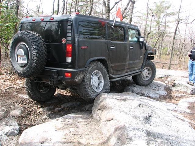

I changed the tie rods & stabilizer. Have Rubber Duck ucp, but the tires were obviously the best improvement. I have made several trips of over 4000 miles with some off-roading thrown in.
The best thing for the most improvement. And they look great!
Attachment 29733
Attachment 29733
Looks good OH! How were the MT's on the road for extended trips?

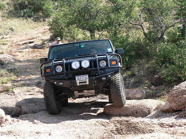

You have 37" ALL terrains? The ones in the pics are MUD Terrains.

BTW who makes that front bumper?
I have driven them on 2 separate trips of almost 5000 miles each. Both times we took a detour for some off-roading. On Friday, we leave from NY to go to Moab and then the Rubicon. This trip will be over 8000 miles before we get back in 6 weeks. I don't anticipate any problems with them. I run them at 40 lbs. Makes steering them on the street easier. Off-road, I drop them to 20.
OOPS. Just noticed you are talking about AT's. Mine are MT's. Nevermind.
