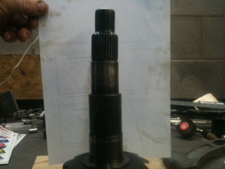

Hi Mark i am doing ok, i can you they did not test it with the tool or they would not just be replacing parts. Plus didn't they test drive it after the steering box change? If they did they should know it was not right. On a side note i just bought a set of used gears with 15,000 miles on them from a end rear shop in BC. IWE Rear Ends Only. so i rip my truck apart then go to press the new bearing on and pinion and its bent. I have been a class A mechanic for 26 years and never seen that before they bent it 1/4 inch pressing the bearing off i think, then sent it to me. I AM SO PISSED OFF i left them a message on the phone and emailed a picture i can't Believe they sent it out. Its very easy to see right on the bench that its bent. Sorry Mark for go off the thread but I AM SO FU_KING PISSED OFF. so then i put it all back together again with the old gears. I will have to see what they will do or if their service is sh-t.

Originally Posted by twr
Hi i can you they did not test it with the tool or they would not just be replacing parts. Plus didn't they test drive it after the steering box change? If they did they should knew it was not right. On a side note i just bought a set of used gears with 15,000 miles on them from a end rear shop in BC IWE Rear Ends Only. so i rip my truck apart then go to press the new bearing on and pinion and its bent. I have been a class A mechanic for 26 years and never seen that before they bent it 1/4 inch pressing the bearing off i think, then sent it to me. I AM SO PISSED OFF i left them a message on the phone and emailed a picture i can't Believe they sent it out. Its very easy to see right on the bench that its bent. Sorry Mark for go off the tread but I AM SO FU_KING PISSED OFF. I will have to see what they will do or if their service is sh-t.
Attachment 53640
Dude, I get it man.... I hate that shiet. Hopefully it’s an oversight and they just replace it.
I hate when I do shiet like that when I call them up, they quickly want to say I did it. If I did it, I’ll fukking tell ya.
Mark
PS What were you buying? A complete hogs head or just ring and pinion?
PSS. Nevermind, I forgot you posted a pic... DUH!
