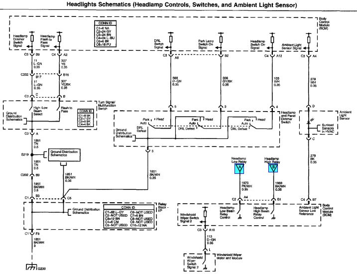

Screw it, here's the diagram. If you have any more questions, ask

I only see one relay for the low beams diagram is hard to read without my glasses on haha so I apologize

you should be able to zoom in w/ your browser or save the image and zoom.
ok, 2 relays for headlights...one for high, one for low. You said realy in your responce. Are you sure you had the correct low beam relay?
The body control module sends the signal to the relay. Do you have any other odd issues inside the truck? These are not physical switches anymore, its data through a computer network.

LO HDLP Left upper box in the second pic.
Have you physically swapped the High Beam relay w/ the Low Beam relay?
If both side lows are not working...I dont know how long the run is after the relay before it splits to the left/right low beam run. But it has to be before that split. The low beams share the same ground w/ the highs. Two of those posts where the relay plugs in should have 12V. One is the signal from the Body Control Module and the 4th is the output to lights.
When you toggle between high/low beams, does the instrument cluster show the brights going on and off?
Are these headlights completely stock? No HIDS, No little boxes plugged into the headlight harness, etc... Have you actually checked for voltage at the bulb socket?
