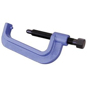

C-clamp will work, but this will work a hell of a lot better!
OTC 7822A GM torsion Bar Unloading tool
