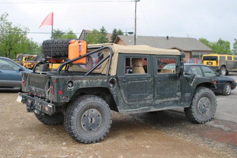

I do have a picture I found on the HML of the bed-rack. I don't know who's truck this is, nice though.
enjoy
Ron

here's another angle.
I like this rack because you maintain visibility out the back, only increase the vehicle's height by 2 or 3 inches and have full use of the bed for larger items (more beer).
Ron

hey that's a really nice truck and that rack is really cool.
Just so happens I have a few more pictures of it on my website for those interested.
One word of caution, Unlimited Offroad has gained a very bad rep lately with making promises and not delivering. I will say that my transaction though not smooth ended up working out. Take it for what its worth. Lynch also sells a rack similar though I don't think there's has the gas can and hilift mounts. The rack is very cool and real nice so I can only hope things for billy and rachael work out in the end.
