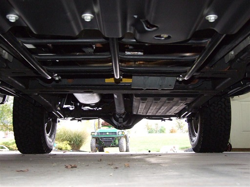

hi. do you have to remove the under carriage to remove the transmission pan to get to the filter or can you slide it out to the side? thanks in advance. i know on my escalade i had to drop the y-pipe for the exhaust to get the transmission pan out to get to the filter.

should just have to remove the skid plate/UCP's to gain access.

Yep.

That's one of the cleanest undercarriages I've ever seen on an H2!
I agree. It looks so fresh & clean.

mission accomplished...changed transmission fluid and filter. on my 08(6.2 l). i had to drop the y-pipe for the exhaust to get the pan out just like my escalade. wasn't too bad..i had to use a 3' breaker bar to remove the nuts from the studs on the header.

jeesh....his john deere is dirtier than his H2
