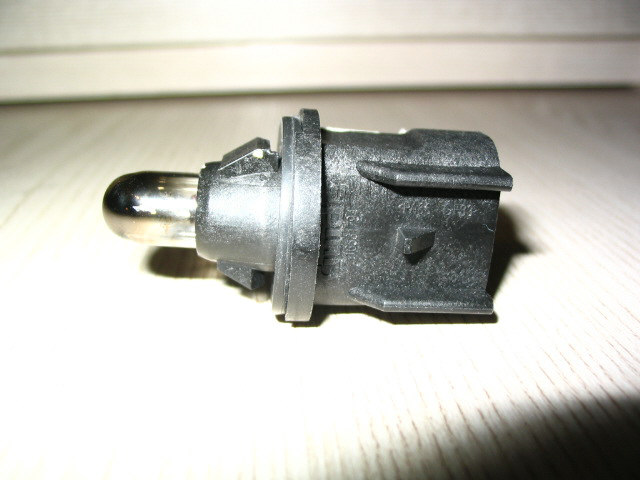

Ok guys, I try pulling like hell to get the bulb out of this unit, no luck at all . Here is a picture of what I am working on.

Second picture, does this bulb come out of this housing unit. If so the bulb is stuck in it.

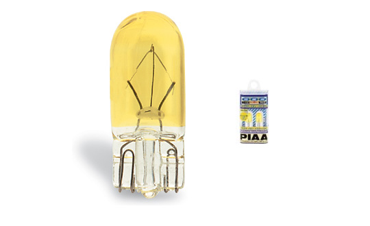

Wrap a piece of duct tape around the glass envelope. Leave a tail on the tape. Pull hard. If it melted itself in, it will come out but you may need to replace the socket if you can't clean it up or if the contacts are broken. It's a simple #168 wedge bulb. The one in the photo is a tinted one made by PIAA, but any clear, cheap 168 will work just fine. Sorry for the tease.

WOW!!!! What a night, as I was trying to remove the bulb, it brakes! Thank God that I own a mobile Locksmithing Business, so I was able to use some of my locksmithing tools to remove the broken glass that was left in housing unit.
I was able to clean the housing unit all out.
I would like to say thanks for all of your input on removing the bulb, and thanks for the parts number on the bulb.
