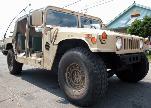

Old 01-13-2006, 11:48 PM
Location: The Green Mountains
Posts: 2,823
VTSTOMPER is off the scale
I like these!

I like these! </div></BLOCKQUOTE>
Hmmm. I wonder if mounting the duals on the trailing edge of the bed rack would work? Probably cut range toward the front, yes?
