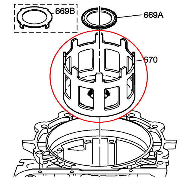

Chances are that you also don't have reverse and it's probably a broken spline on the reaction sun shell. It's the round cage thing with the red blinking circle around it.

We have been having alot of failures with the reaction sun shell but not just with the H2's, also all the other models..

The 2nd and 4th gear bands or out in mine. (I still have reverse). I wonder if I'm asking too much of my truck. How often will the Tranny fail with my current demands.

Ignition switch issues causing a trans problem will give you a service engine soon light, and
cause you to start up in 3rd gear when it is acting up. If you lost 2nd and 4th, it burned up the 2-4 band. There is a PI bulletin on this. They will probably rebuild it, with a new updated design input housing.
