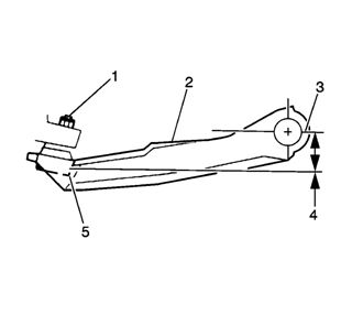

Z height ... where I can measure ? and what is the measure ?

Z height is 4.8 inch - 122 mm.
Z height is the n. 4.
But i think that the drawing is wrong !!!
The drawing come from GM !

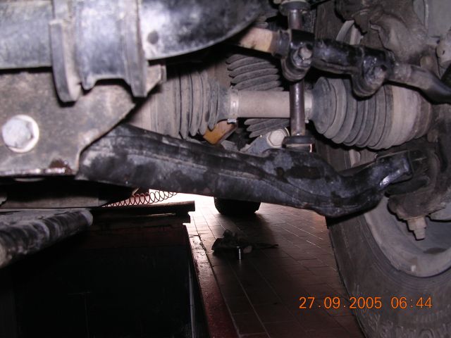

I am a little confused, granted a little late to the game, but confused nonetheless. I believe you said when the tire is at full droop (tire in the air) is when the tie rod and sway bars hit.
I believe the torsion bar adjustments should have no effect on this since this is a product of the limitation of the suspension, not the pre-load provided by the torsion bar.
It would appear there is the possibility it is the design of those tie rods that is creating the problem. They might not be offering the clearance at full droop that the stock and Fabtech tie rods do.

this is the pics. we have now increased the sway bar connectors... but the lower arms (we call trapezio) have a distance from the ground with stock tires of only 26 cm 10.3" and I have crancked all the torsion bar.. A stock h2 have a clearance of 28 cm in this point.. Someone say that is possible that the first owner (but the H2 have only 1000 km when i have buyed) have change the camm on the torsion bar with another with other design ?!?!?
