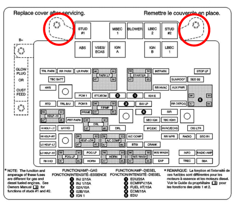

DOes anybody have a good clean way to connect the to the battery for lights, amps, inverter etc. i was going to add the double battery option but wanted to see if there is something like a seconf fuse panel that can located close to the battery that i can then run all the other stuff from. I have made fuse panels before but was hoping there are more custom or cleaner set ups now. Pictures are best

DOes anybody have a good clean way to connect the to the battery for lights, amps, inverter etc. i was going to add the double battery option but wanted to see if there is something like a seconf fuse panel that can located close to the battery that i can then run all the other stuff from. I have made fuse panels before but was hoping there are more custom or cleaner set ups now. Pictures are best </div></BLOCKQUOTE>There are two posts in the large fuse box under the hood. Stud 1 and Stud 2. They are fused and are good for attaching some accessories.

i don't have pics, but i added a distribution block under the black plate that holds the hood support near the fake intake on the drivers side. there are probably other places to put them, but this was out of the way. i only have 2 outputs right now for front and rear winch cables. fuses for them consist of pieces of 3/8" aluminum bar, doubtful they'll pop anytime soon.
