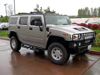

That is very helpful. I will (or I'll have the dealer) check my Z height adjustment. Here's a pic of an H2 from an official GM/H2 web site. The thing looks like it's squatting also!
2003 Yellow H2 LUX (Sold)

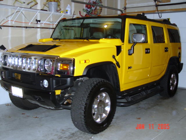

Here's my new (to me) 2003 H2 with 17K miles and air ride. It squats as well with a 9" measurement in the rear and 8"s in the rear. Damn! Back to the dealer!
