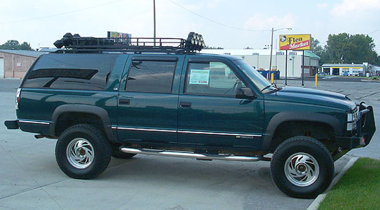

I have the optima yellow in my Sub.. Have left lights front lights on along with the red and blues for along time at Crime/accident scenes.. Left interior light on for 2 days and never killed the battery.... I buy the biggest damn battery that will fit .. Attached is pix with lights.
Consider the OPtima before yo go the dual battery option.
