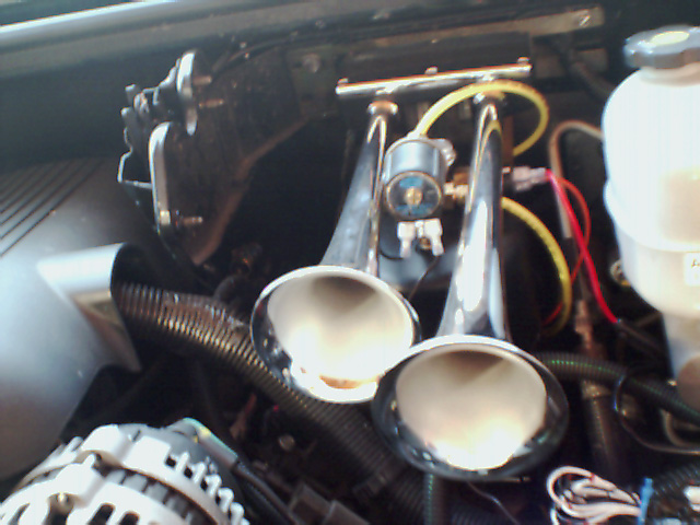

Ok here you go. The install is very easy, just 2 important things to remember.
1. Check that the wires are secure on the air horn (mine fell off) and if loose just crimp them a little.
2. Make sure when you put the cutout on the firewall to mark your hole to drill you triple check that the placement will be exact.

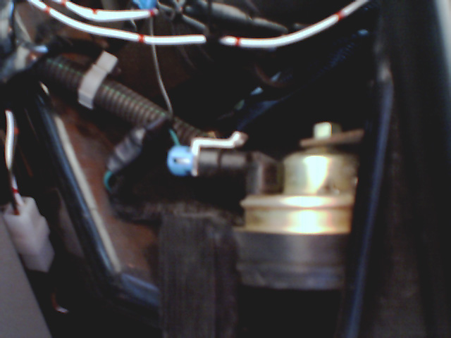

As far as wiring it up goes that is a breeze if you want it to run when you push your horn button. Red wire goes to your battery +, and the black wire gets routed to the factory horn and spliced in with the green horn wire.

Nice install. So, if I may ask, what's the brand and price for that airhorn setup? Does the mounting to the firewall use sheetmetal screws? Hopefully you don't have to get access to the other side.

It is the Real Wheels airhorn, I think it is around $360.00 or something like that.
The 2 bolts that hold the hood latch on are used for one side of the mounting bracket and you have to drill a hole on the other side and use one of those things that acts like a nut if you can't get to the back of something. Not a clue what it is called, but you don't have to get behind the firewall.

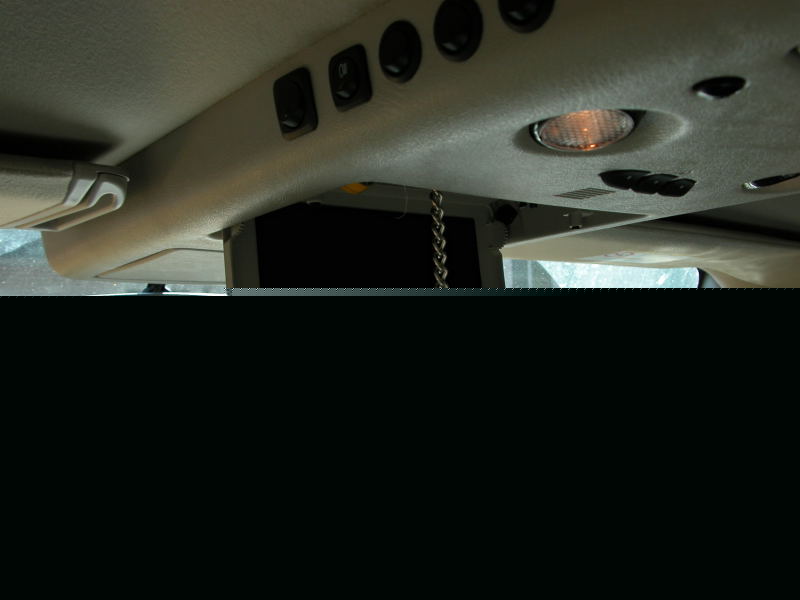

might I offer a suggestion. I feel the lanyard valve is the best way to control the horn. the push buttons do not allow you to control the volume (by that I mean the mass) of air you supply to the horn. with my lanyard valve, it is very easy to give very short lower volume toots. for when I pass kids on the street and they are waving or something (something that happens fairly often) or when I see someone I know. when I want to unleash fury, I pull down hard. plus the lanyard give you that extra added trucker feel to it. push buttons are for suckers.
