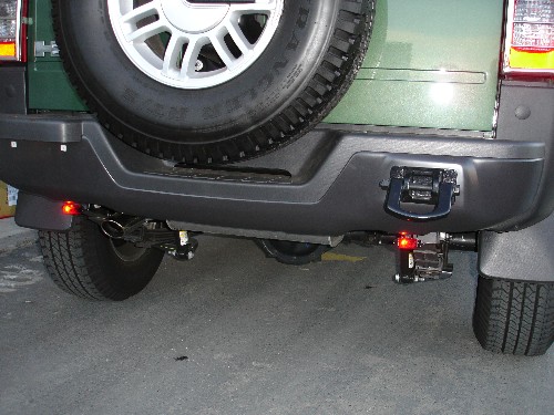

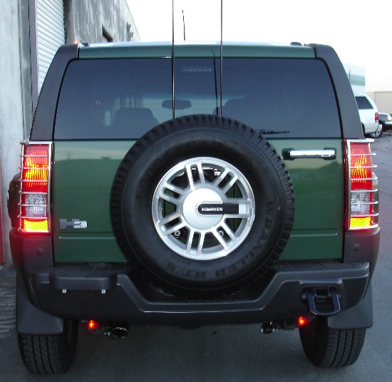

I finally got around to this install. I fabricated a thin piece of metal and drilled three holes in it. The middle hole goes through the factory bolt and the two others connect to the lights. I made the connectors to the lights quick disconnect in case I do some heavy off-roading. I don't want to rip them off.
They don't really decrease the approach angle but you never know. Thanks again f5fstop for the wiring information.

Green Lantern I noticed the CB radio antennas can you let me know how you installed these? Or take a picture? I have a tall off - road flag I want to install to the base of the spare tire but would like to see some pics. if possible.
