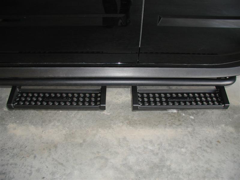

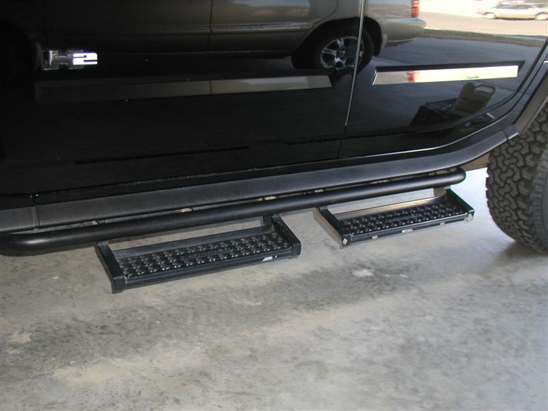

Old 04-08-2006, 01:51 PM
dochummer's Avatar
Location: Eastern Washington
Posts: 2,452
Before
'03 H2
Old 04-08-2006, 01:52 PM
dochummer's Avatar
Posts: 2,452
After
'03 H2

Looks Good doc! But ya shoulda CHROMED them
