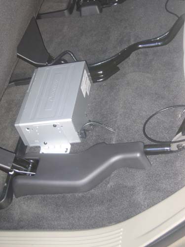

I have finally finished and got the chance to take pictures for you who are interested.

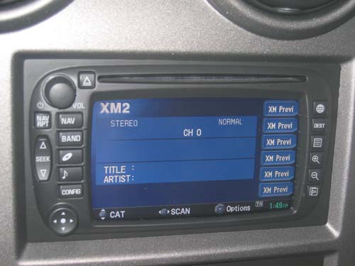

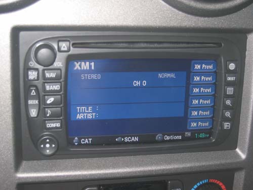

XM1

Here is the other XM option.

Here is the changer. It does not intefere with the seats folding down and this is the 12 disc.

Looks very usable to me.
Please photo the antenna.

I do not have the xm module installed yet. "Santa" is bring that this year I will post more pics when I have the xm installed.

Can you hook up a 12 disc changer to the '03 radio?

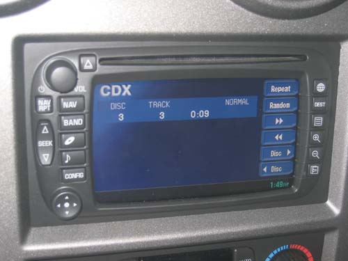

The nav unit is the factory one that comes in the 2004. The adapter is the soundgate one. You can get that at www.logjamelectronics.com it is cheapest there. The cd changer is the cdxp-1280 from pioneer. That is the only parts I needed. The XM module is coming for Christmas. I love it a lot. Espicially because the steering wheel controls are still functional with this setup. Hope this helps. Let me know if you need any more info.
DVJ,
I am pretty sure you can. www.soundgate.com is where I got the adapter and they will be able to answer all your technical questions about that. Hope that helps.

Hey - nice setup. As you know, I am very interested in your setup (Remember I started the post "2004 Nav System Challenge" to get someone to try what you have done.
Good to hear you can use the changer with the Nav at the same time.
Question - Can you get the track information to show on the display of the Nav (Artist, song Title) or do you simply get the track number and time remaining?
Good work!

I will get some pictures tomorrow of how it works in nav mode. I simply forgot to today. It will not show the artist and track name in either mode. I am not sure if this is something it is capable of or not. I plan on e-mailing soundgate with these questions. In nav mode it will display the track and disc number and time remaining. This is good enough for me since now I have hte best of both worlds. Navigation and multi-disc changer at the same time. I am loving every minute of it. Let me know if any more questions.

I believe it depends on the CD. Some are "coded" to show artist and song name, others are not.
In my home system some show up and others don't. I don't think this is the head unit as much as the individual CD.
I am anxious, however, to see if XM shows those items in their entirety. On mine, I only get 8 digits (03).
