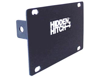

01-10-2003, 06:00 AM
Posts: 1,415
HummieH2, are you saying you have a license plate holder with bulit-in tube/bar on the back of the plate that fits into the front 2" receiver? (that's the square hole.) Same as a rear hitch step fits into the rear 2" receiver. That would be great. I have not seen anything like that, must do some search on the net. I have seen all sort of stuffs for 2" hitch receivers, step, logo, cover, but not yet a license plate holder. Any one has a source?

01-10-2003, 12:21 PM
Location: La Porte,TX
Posts: 391
No MAC...
I wasn't talking about the hitch reciever. Iwas talking about the bolt hole had inserts and screws already in them when we picked it up a dealer. Maybe dealer installed them when it went through PDI. A hitch step would work with plate mounted to it.
Don
01-10-2003, 02:34 PM
Posts: 1,415
Looks like JCJ has the bullseye hit. Thanks a million, well, thanks $26.95. Thanks to all, hope it helps many others too. Every time I visit the forum, I usually check the Tech section first and save the goodies others found on PC.
