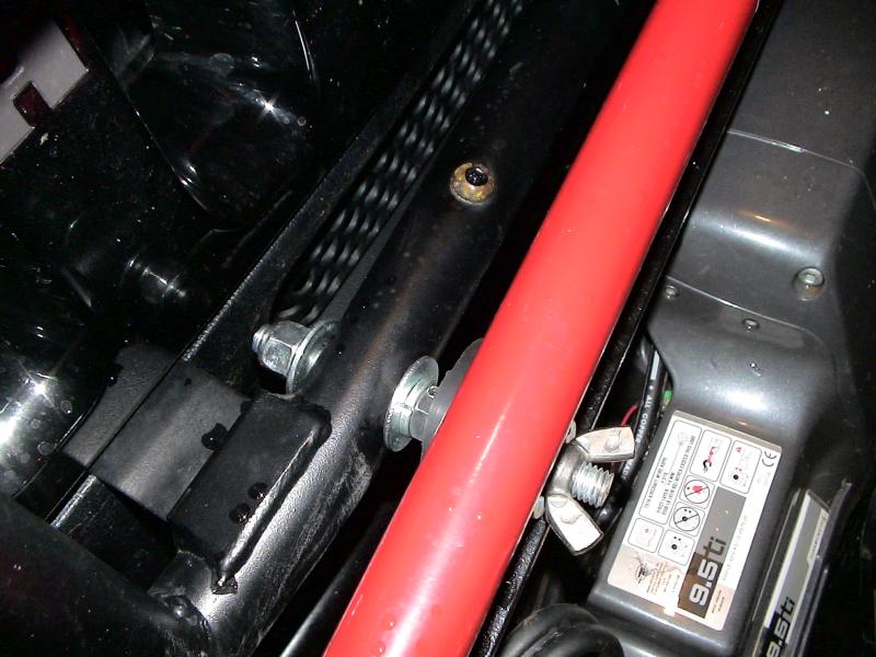

First Off, Dry Heat did it FIRST. I just took his idea and adapted it a bit to my own aftermarket brush guard.
I did not want the hi lift inside the truck and I did not want it on top. Dry Heat's idea of solid mounting the hi lift worked out great for me.
Just had to drill a couple of holes as my guard did not have the same mount points. It is extremely solid.
I used aircraft style locking nuts as well to give me some added security. I also used stainless steel wingnuts as I think it makes the wingnuts easier to turn under hard pressure.
Also, the one part of Dry Heat's setup that I could not replicate is the rubber bushings, so we bought a $5 rubber mallet and hacked the ends off of it. Worked out great.

We spent all day today on some very demanding trails at Barnwell Mountain and the mount came through like a champ. Solid as a rock.

Can you still open the hood with this set up???
Old 06-23-2006, 03:42 AM
Default Re: Brush Guard Mounted Hi Lift
frgmstr isn't around anymore, but if you can't, it's just held on with a couple of wing nuts.
