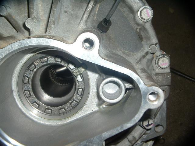

Default Re: manual for e locker?
Keep the wires from the coil straight as possible, avoid any loops that will later become a kink and cause the wires to break @ the kink (don't ask how I know). Position the shoe on the coil between the webs on the case where it fits the tightest thus keeping any rotational movement in the coil as little as possible.
Here is a pic of where I broke mine out at:
ok, so any problems w/ water intrusion from the wire hole/grommett?
any suggestions to waterproof??
I've been through 32" creeks(called rivers out here) before w/out prob.s, don't want to create any.
Thx
Thx
No problems so far. Been in for about 2 years and under water some. That rubber grommett fits tight if the correct size hole is drilled through the case. Use some RTV around the outside if you are worried. I believe water would find its way past the axle seals first.
