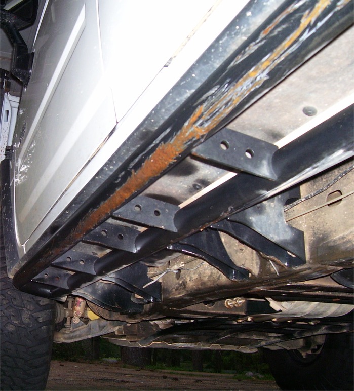

Anyone try to rattle can their side steps? I have a black pair that are pretty messed up. Trying to save them. Any advise?

Default Re: Dupi-Color Tube Steps
If you're going to keep banging them up, just rattle can them. The powder coating will come off under abuse so there's really no reason to pay for it over and over.
Duplicolor Truck Bed Liner works well and has a texture that will help hide any small scrapes and bruises.
Yeah mine takes a lot of beating. I heard great things about Duplicolor. What did you do to prepare them? Just a good wash?
Heck no. I took those chrome things off within one hour of arriving home.
However, I have used it on other things. Just wash them and scrap off any and all rust. Use several coats until you are happy with the finish. It takes a long time for the truck bed liner to cure. It'll be soft for several days but it will harden up.
Another route to go is just plain old flat black paint.

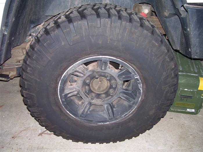

Originally Posted by PhilD
I'll tell you how well it works out in a few months, but my rims were chrome, so I scuffed the surface up, primed them, and painted them with Rustoleum hammered finish paint. They don't exactly look "factory", but they look good enough and should be easy to touch up.
[IMG]http://www.*******club.com/forum/files/picture005_293.jpg[/IMG]
Thanks Phil. Your rig is looking very nice. I always wondered how long it would last. Did you unmount your rim's to rattle can them or just tape them off?
I took the rims off the vehicle, but left the tires on the rims.
Thanks Phil. I'll have to get a friend over with a jack and see how mine turn out.
Painted chrome? Unfortunately Phil, I don't see that lasting. What did you scuff them up with? Shy of sand/media blasting them, I don't see anything sticking for any amount of time.
Hope I'm wrong but after being in the bodyshop for 25 years, I've seen my share of chrome painted parts and have yet to seen one survive a stone chip, etc.
