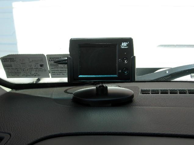

Here are some pictures of the PepBoys back up camera and monitor ($99). I added NdBFe magnets to the base of the monitor and to the underneath the removable dash trim piece using double sided table. The monitor can be easily moved (just held in place by the permanent magnets) to clean the windshield. The cable with slack was run between the windshield and the dash down to the firewall connector. The camera was mounted to the right of the hitch using a homemade Al bracket painted black (there is a hole in the hitch already underneath the sticker). The camera sits inside this "cove" so water doesn't drip down on it from the bumper. The system can be manually turned on by a button on the monitor and automatically turns on when you put the tranny in reverse. I can see about one foot behind the bumper out and the spare doesn't block the view.

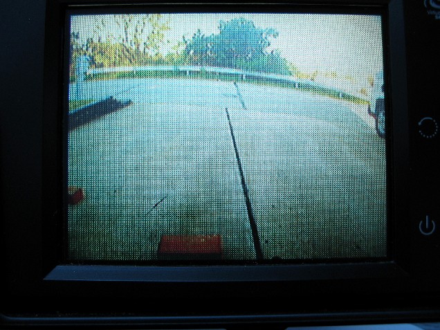

Look's like a deal. How's the video quality? Can you post a picture of the image?

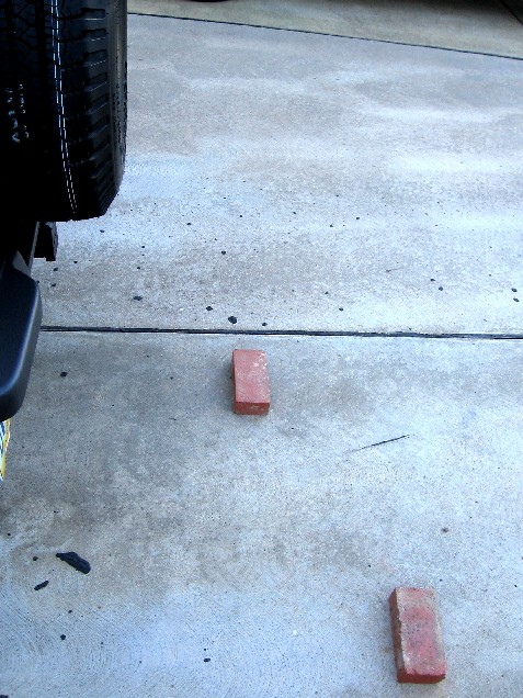

Here is a picture of the connector. It is right behind the battery. I tied into the light green wire at the bottom of the connector (the portion that goes back to the hitch becuase it has more slick to work with. I removed some of the insulation and soldered to the wire versus using a splice connector.

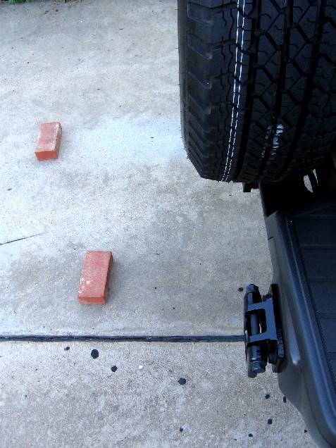

Here is is picture of the screen. The picture didn't turn out well; the monitor has much better resolution than this. No problem seeing the picture in bright sunlight. There are two bricks shown in the monitor picture. Here are two pictures from either side in the rear to show you where the bricks are. The center brick is about 1 foot behind a back of the spare. I can adjust how close I can see to the rear by bending the homemade bracket.

I dont see a picture of the screen only 2 pics of side view of the bricks.
My mistake. Here it is.
