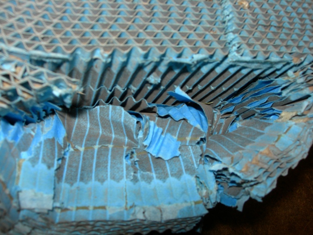

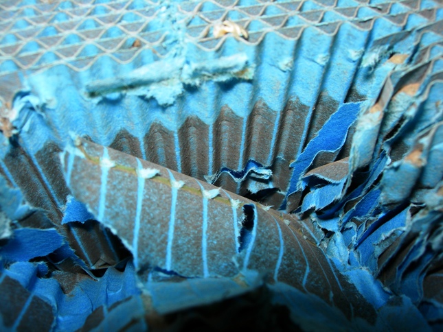

The dust absolutely poured out of it like it was bowful of sand. I hacked into the old one and each flute was complete caked with dust. Major oops and self-

Check this out. Ya think I needed a change?

Kids, do not try this at home.
Boy is your car going to run good! WOW!
