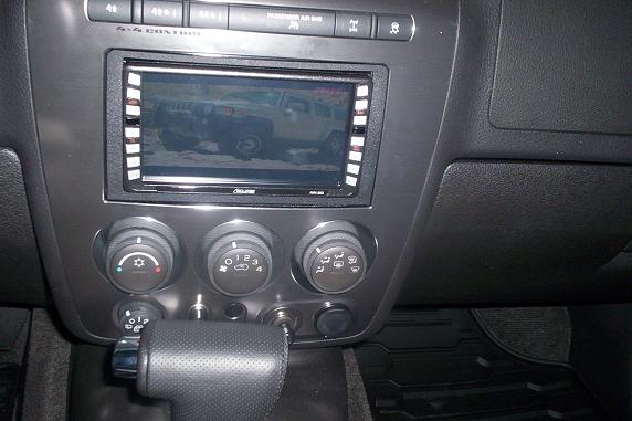

I have the eclipse and havent had trouble with it since installed in January.GPS is great make sure you instal a switch for dvd to run while driving.Rear camera is great too.You can pick up remotes on e bay cheap.
I had it installed by highly recomended installer.

i have the pineer avic-z1. dont have a pic with me but i can post later. I havent had any problems with it, had it since july. GPS is accurate. Lots of features. There are 2 ways to bypass the unit depending on the manufacture date( if early build it will cost you either 30 bucks, or if you do it youself free, and if its later build the bypass is just inserting a wire and grounding it) both simple and everything is unlocked all the time, including dvd. I installed it myself, had never installed anything in a car before. Took me about 6-7 hours with breaks, some of the more knowledgeble people on here said it took them 4 hours, so you can judge teh difficulty.
if you have any more specif questins id be hapy to help.

Now to the original question; I'm going to guess the installation of either the Eclipse or the Pioneer AVIC units is about the same. Adapters are required for the Pioneer install, and I believe adapters are also required for the Eclipse install. The rear camera will have to have the wires run into the vehicle to the head unit.

Z1 has better interfaces and better screen. Eclipse has much better mapping, better sound, and is more reliable. The bluetooth on the Z1 is almost useless so don't buy it for that option. Z1 will do either XM or Sirius or both, whereas Eclipse does just Sirius for now. Install is the same for either, and neither will display any info from Onstar as that is strictly on the serial II databus and not intepreted by the aftermarket head unit.
