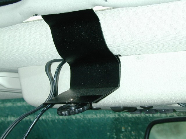

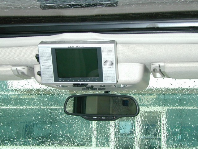

I have installed a video monitor above the rear view mirror and did it without drilling any holes. I made a template out of cardboard and made the bracket to match out of thin guage stainless and powder coated it. The bracket fits under the sunroof trim and clips behind the upper consul housing. The wiring ran without any holes and the power supply was fused and wired into the back-up lights. It powers up only in reverse and the micro camera is mounted in a 1"x1" custom housing attached to the top, inside,center of the rear window. Invisible from the outside and wide lens eliminates the low blind spot. I hope these pics tell the story.

Pics sent one at a time. Let me know if these 2 help.
03-30-2004, 02:53 PM
Join Date: Mar 2004
Location: Toronto, Canada
Posts: 31
Monitor pic.
03-30-2004, 02:57 PM
Join Date: Mar 2004
Posts: 31
Hope this pic opens.

H2Finally,
I do not use my camera for hooking up my trailers. I use it as a safety measure so that I don't back over kids or dogs (cats are ok). The wide lens gets a couple of inches past the hitch. Too much flash glare to post the pic of the view. Here's the camera mount..
